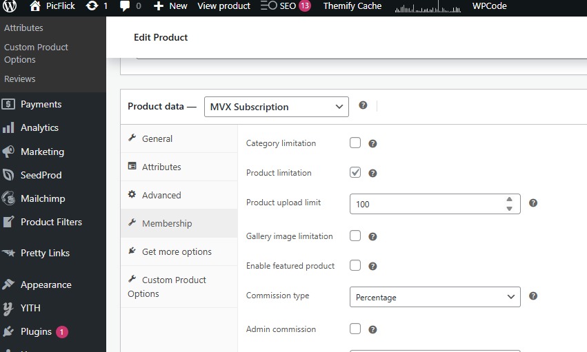

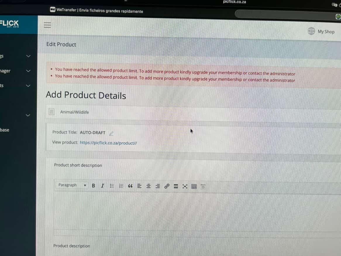

      Once of my vendors have reported that they cannot upload more products as the dashboard is showing them an error that they have reached the product limit (see attached).
      We have configured a limit of 100 product upload on this membership level, and checked that they are correctly assigned to this level. We also checked their current product upload count, and it is showing only 1. Please see attached 2 pictures
      Please can you advise what possible issue could be causing this. I will share access to Staging environment in reply below.

    • #251158
      As per my previous post image (Membership-config.jpeg) – the product limit has been set to 100 and my vendors cannot upload greater than 1.

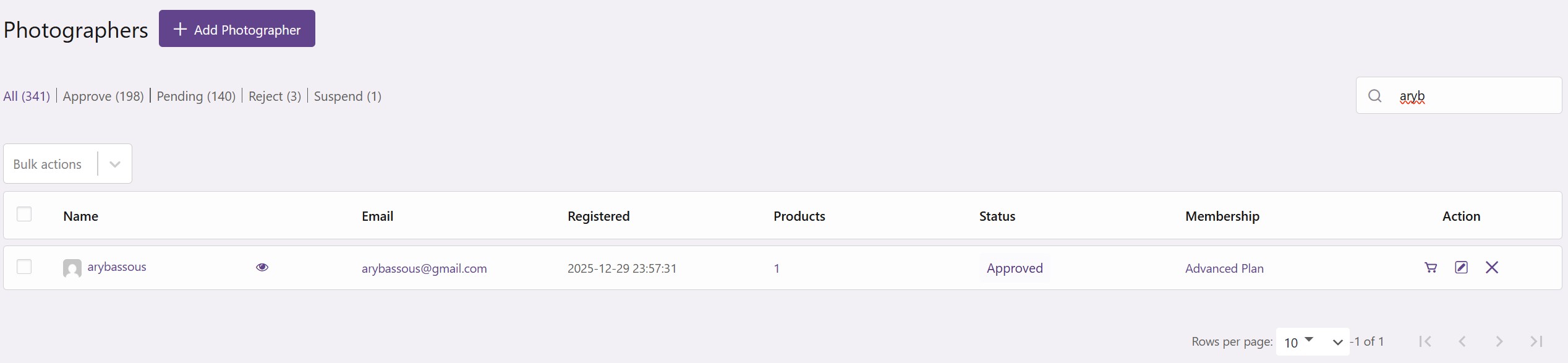

    • #251707
      I’d like to report that another user has experienced this issue – they uploaded 1 product and then when they tried to upload another, it stated that they have hit their limit.
      This is now the 2nd instance of my users experiencing this issue which is significantly hindering our business.
