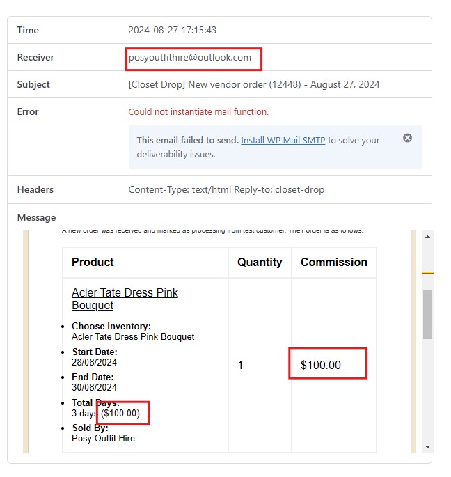

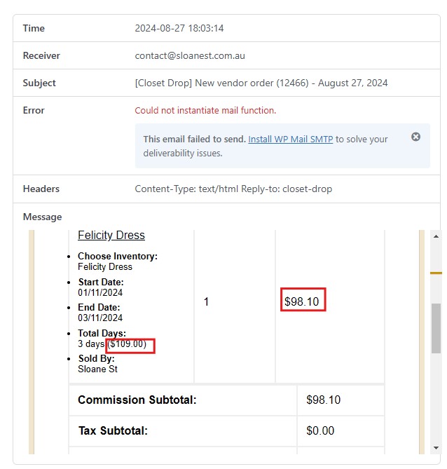

      here is my staging site.
      https://closetdrop.webstein.com.au/
      If customer rent product from this vendor
      https://closetdrop.webstein.com.au/vendor/sloane-st/
      the vendor will get 90% of their commission
      if purchase from other vendor
      example:
      https://closetdrop.webstein.com.au/vendor/maysonjmiles/
      the vendor will get 100% of their commission
      what we trying to do is set 100% commission for all vendor.
      currently we use default astra theme (without customization) just for testing purpose.
    • #234745
      Hi Simon Thomas,Thank you for reaching out to us.
      It looks like the vendor-wise commission for the vendor Sloane St has been set to 90%, which is why their commissions are being calculated accordingly. To verify this, please navigate to your admin dashboard and go to MultiVendorX > Vendors. Locate the vendor details page for Sloane St, and check the commission settings under the “Payment” tab (you can reference this screenshot: https://prnt.sc/VBa1ZEhwDmff).
      Since you want all your vendors to receive 100% commission on their product sales, you’ll need to set the global commission to 100% and adjust the revenue-sharing mode to “Vendor Commission” (here’s a guide: https://prnt.sc/yEWKihaD0cGi).

      @Simon Thomas, thanks for sharing the access details. We reviewed your site and found that the commission for the “Business” membership plan is set to 100%. This means vendors under this plan should receive 100% of the product price as their commission.
      To ensure accuracy, we’ve set other commissions to 0 on your end. We recommend placing orders again with the vendor who received a lower amount to verify that the commission is being correctly generated.

      Hello, Thank you for confirming.
      We have updated the MultiVendorX and MultiVendorX Pro plugins to their latest versions and set the global commission to 100% (see screenshot: https://prnt.sc/auzlWPwJTMpa). As a result, the specified vendor on your end in now receiving 100% of the product amount as commission.
      Please verify this on your side and let us know if you need any further assistance.
