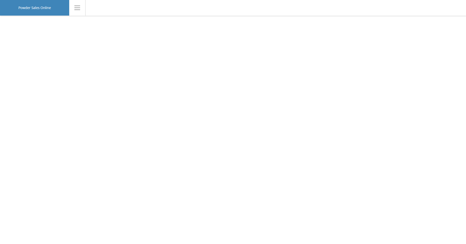

      Hi when i login i just get a blank dashboard see screen grab
    • #239525
      Hello @alistair, Sorry to hear you’re facing an issue.
      It looks like there might be a theme or plugin conflict on your end. To troubleshoot, please try the following steps:
      — Deactivate all plugins except WooCommerce and MultiVendorX
      — Switch to a default theme like Twenty Twenty-Five or Storefront
      — Check if the issue still persists
      If the issue remains even with the default theme and plugins, please set up a staging site (a replica of your live site) and share the staging URL, temporary admin, and FTP access with us so we can investigate further and assist you accordingly.
      Also when sharing access, please mark your reply as private for security.

    • #239540
      alistair
      Seems it was this function that was causing the error any idea how to fix it:
      *add_filter( ‘mvx_vendor_dashboard_header_nav’, ‘filter_mvx_vendor_dashboard_header_nav’, 10, 1 );{
      unset($header_nav[‘shop-link’]); //remove Vendor Shop Link
      return $header_nav;
      function my_page_template_redirect()
      if( is_tax( ‘dc_vendor_shop’ ) )
      $shop_page_url = get_permalink( woocommerce_get_page_id( ‘shop’ ) );
      wp_safe_redirect($shop_page_url);
      exit();
      add_action( ‘template_redirect’, ‘my_page_template_redirect’, 999 );
      add_filter( ‘doing_it_wrong_trigger_error’, ‘__return_false’ );
    • #239544
      Hi, thanks for your response. Could you confirm if everything works fine after removing the shared code?
    • #239548
      alistair
      Yes it does
