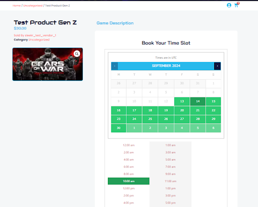

      I’ve noticed an issue when a vendor tries to add a booking for a bookable product from the vendor dashboard. If the product’s booking duration is set to hours, there’s no option to select the time, unlike when booking from the site frontend.

      Upon reviewing the manual booking process in the WooCommerce Booking section via the WordPress dashboard, I am able to see the time selection option after choosing a date. Please refer to the screenshot I’ve attached for further clarification.
      If a product has the “Booking duration” attribute set to hours, this time selection feature appears both on the front end for users and during manual bookings through the WooCommerce ‘Add Booking’ option.
