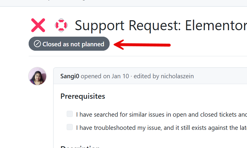

      ooking at the github link above, it seems they have closed the request so I doubt you’ll get anymore support this way. Also, they did ask who ‘We’ are, so it was not clear that you were asking on behalf of MVX. From what I can deduce they think this is a personal request, rather than coming from a company..

    • #239356
      Thank you for your insights. We did notice that the original GitHub request was closed, so after that, we created another thread seeking assistance. However, we still haven’t received any impactful support from their team.
