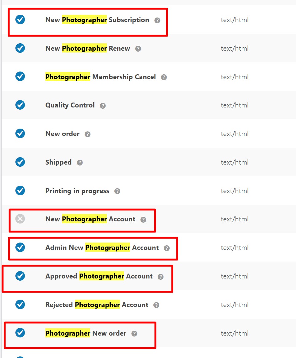

Question 1 – Please explain the order and triggers of emails that will be sent to the vendor when they purchase a subscription. I see many types listed in the WooCommerce >> Emails tab and am not sure which get triggered when? (new vendor order, new vendor account, new vendor subscription?!?!?!) Please explain for each step in the sign up journey.
>>In the default configuration of the membership module, when a vendor registers by subscribing to a membership plan, the following email notifications are sent:
To the admin:New vendor account notification
New order notificationTo the vendor:
Account creation confirmation
Order completion notification
New vendor subscription confirmationThis automated email process keeps both parties informed of the registration and subscription events(https://prnt.sc/sGXnQysw9vgK).
