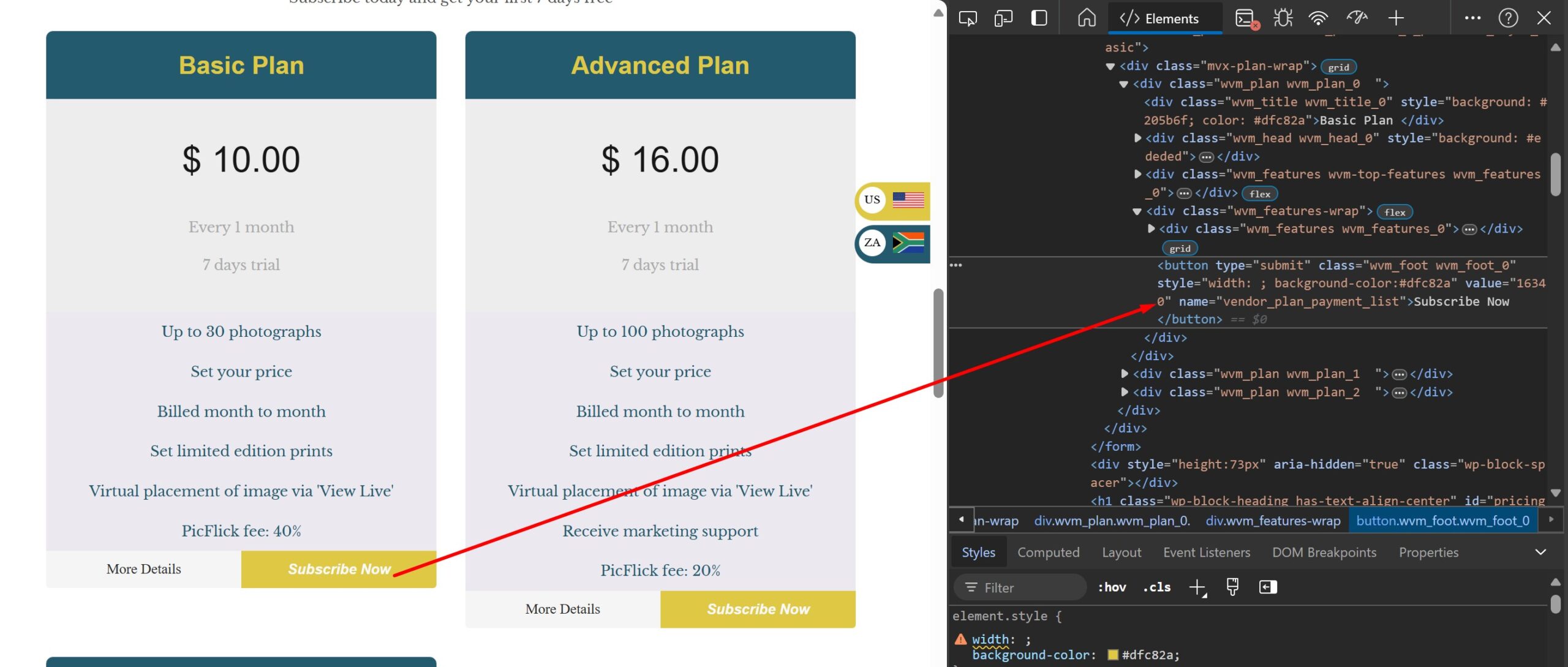

      But I cant seem to find the hyperlink in the default ‘subscribe now’ button in the [vendor plan] default table. How can I copy the button hyperlink please? (see attached).

      Will you also please explain where I can copy the URLfor the “Subscribe now” button. Just like there is a URL for the ‘more details’.
      (see attached)
    • #222164
      Hello there, As mentioned earlier, you’ll need to add custom code by overriding the template file to achieve the desired redirection flow. Currently, there is no built-in option to set a URL for the “Subscribe Now” button by default.

      Thanks. I think I solved it through placing the following code on the webpage.
      <form name="frm_subscribe_vandor_plan" method="post" action="https://staging-d8a8-picflick173179870.wpcomstaging.com/membership-types/">
      <button type="submit" class="wvm_foot wvm_foot_0" style="width: ; background-color:#dfc82a" value="16653" name="vendor_plan_payment_list">Subscribe Now</button>
      </form>
      What do you think?
