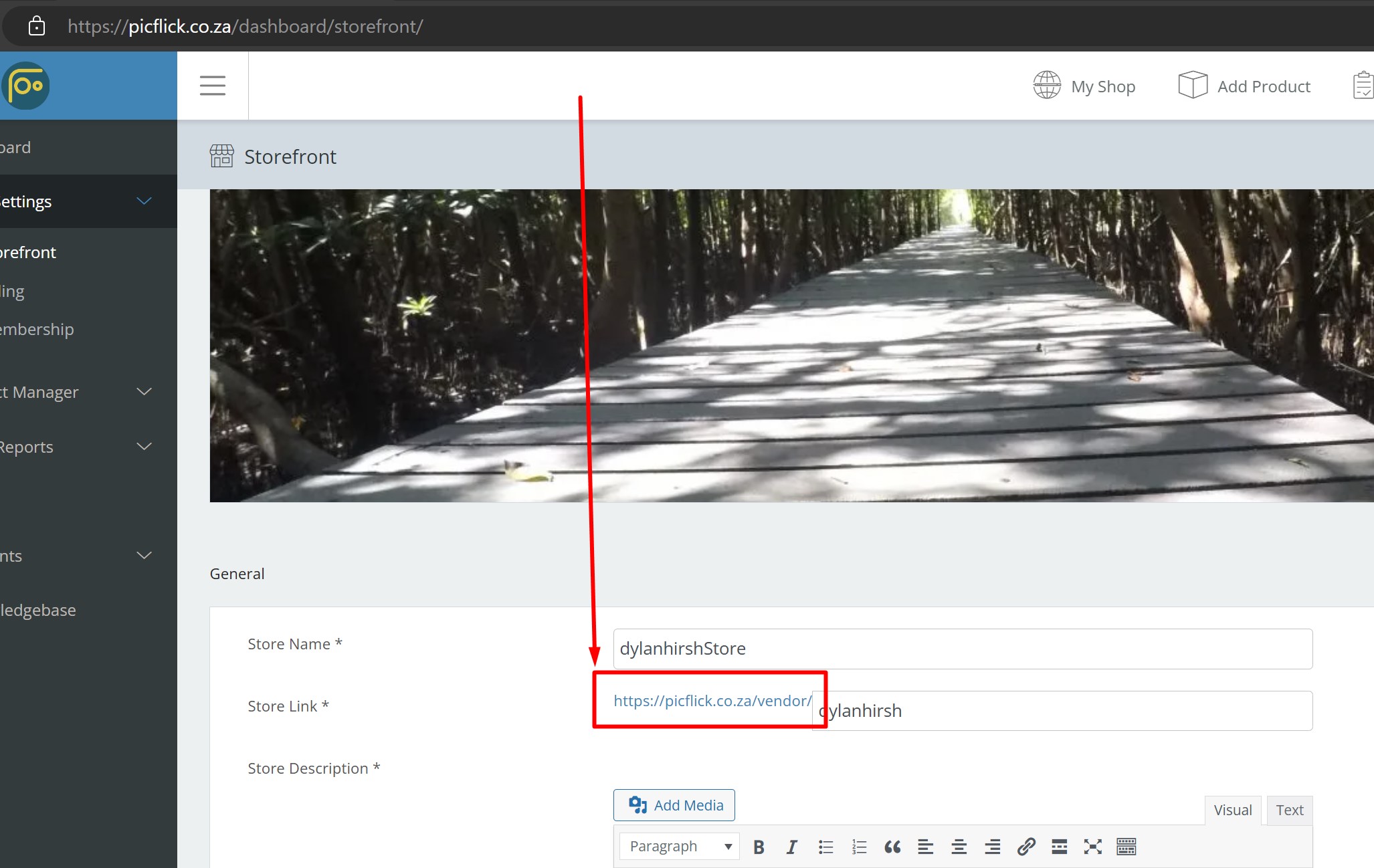

      Actually, sorry 1 more question.
      Where in Loco Translate can I find this Slug String in the https://picflick.co.za/dashboard/storefront/ page (see attached)
      Thanks.
    • #221027
      We have already replied for this over the other thread here : https://multivendorx.com/support-forum/topic/vendor-registration-page-bug/#post-221022. So kindly check there.
