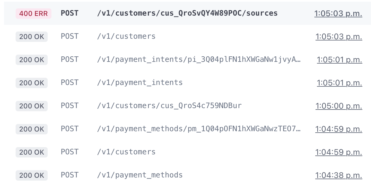

      Hello. I’ve seen two issues pop up with Stripe Marketplace. We are using MVX Pro 1.3.3
      The first is if a payment requires 3D Secure. When your plugin creates a PaymentIntent, and then update that PaymentIntent once again, it normally returns a status of ‘success’ and the payment process is over. However, if 3D Secure is required, the update to PaymentIntent returns ‘requires_action’ and a ‘next_step’ tag that describes what to do next. From what I’ve seen, there is no code in the plugin to deal with that, and the client from then on is in an invalid state in their order.
      The second is if a user clicks on the checkbox to save their credit card info. The Customer creation code is different. The plugin first send a user description with name and username to create the Customer (instead of ‘Name, Guest’). It then uses the customer/CUSTOMER_ID/source endpoint to create a source, with a ‘source’ parameter that contains the id of a PaymentMethod, which is invalid (invalid_request_error
      You cannot use a PaymentMethod as a source for Customers. Instead, use the PaymentMethods API to Attach a Customer to a PaymentMethod. See https://stripe.com/docs/api/payment_methods/attach).
      By the way, this sequence of creating a Customer and updating it with a source happened after the purchase was made (the plugin went through the process of creating a PaymentMethod, a Customer and a PaymentIntent, and updating that PaymentIntent to receive a success), which means the client was charged despite receiving an error message for failed purchase, and then paid us again using a different payment method, unaware that they had already paid us. That’s unacceptable. To be fair, the purchase process takes a long time (up to 20-30 seconds). It’s possible that the user refreshed the page, checked the save box and tried to send a purchase again, and that new customer creation was part of the next purchase attempt. We don’t have server logs due to misconfigured log rotation to confirm what the user tried to do and the user was so mad with being double charged that they were not cooperative for investigation. All we have is the timeline of event from Stripe’s POV (linked in the attachment)
