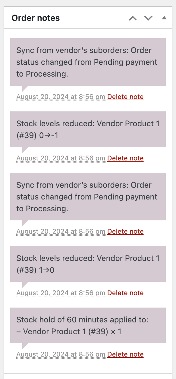

      Hi Support, I have tried to dig through this and solve this myself, but have had no success. I am testing the updated Stripe module before rolling it out on the live site and it seems like the new Stripe integration is working properly as far as payments being accepted and transfers/payouts being made, but within WooCommerce/MultivendorX, I am seeing multiple status updates and if manage stock is enabled on the product, multiple stock reductions. I have email disabled on the sandbox site, so I’m not sure if multiple emails are triggered as well, but there is obviously an issue somewhere if the stock and status are being updated multiple times. Can you please help? My configuration under testing is as follows:
      Stripe Test Mode Enabled
      Stripe Connect – Express
      Separate Charges and Transfers
      Enable Stripe Marketplace
      MVX 4.1.10
      MVX Pro 1.3.6
      WC 8.8.3
      Here are the screenshots of what I am talking about (these are from parent orders, not suborders, but there was only one vendor and one product on each order):
      https://prnt.sc/m3aoxIanq57Q
      https://prnt.sc/K6v2nj6kGYXj

    • #220282
      Justin Harrison
      Hi Sangita, thank you for the update. As I stated in my original post, I have emails disabled in the sandbox site so I don’t know whether multiple email notifications are going out, but I feared they might because of all the duplicate status updates and even the duplicate database records as you should have been able to see in my previous loom video. If you look in my previous loom video, you’ll also see there are LOTS of status updates in the notes… your screenshot is unrelated to the problem I am describing. Please rewatch my loom video and you’ll see that when placing an order, the following order notes show up regarding order status:
      Order status changed from Pending payment to Processing.
      Sync from vendor’s suborders: Order status changed from Pending payment to Processing.
      This is not normal. On the live site where I have not updated MVX, this is certainly not the case nor has it ever happened like this with MVX. There is only one “Order status changed from Pending payment to Processing” on all of our live site orders when an order is placed. I am also including a screenshot (from the same order in the loom video) that shows the timestamp on all the status updates is the same to prove that this is all happening at the time the order is processed and not caused by any action at a later time:
      https://prnt.sc/wNLNCASXT9m_
      Please re-review the loom video in the previous post as it also identifies this issue just like the stock issue. Also note that in my loom video towards the end, I show that there are duplicate database records created for _mvx_vendor_new_order_mail_triggered. Whether or not two emails are sent out or not is, again, unknown since I have email disabled on the sandbox site, but the duplicate records are there in the database.

    • #220685
    • #220689
      Justin Harrison
      @Sangita The fix did not fix the issue. I am still having issues with the stock being reduced multiple times. Here is a test from the latest order: https://prnt.sc/oFgZUy16AJmY
      After reviewing the Github issue, it appears that the only changes were going from wp_get_post_parent_id( $order->get_id() ) to $order->get_parent_id() in two places in the MVX_Order class even though wp_get_post_parent_id is used in a lot of different functions in that class. If that were breaking something, it would need to be updated all over the place. I was surprised when I saw that because I didn’t think there was anything wrong with using either method, but I just have to trust the experts, however this indeed did not fix the problem.
      Please test this fix yourself and address this with your developer. We have been waiting on this fix for weeks now and cannot update MultivendorX until it is fixed.

    • #220758
      Justin Harrison
      Hi Sangita, I have spent a lot of time troubleshooting and have narrowed it down to one setting…. Separate Charges and Transfers. If I keep everything the same and change to Destination charges, the issue does not occur. I will continue trying to debug the issue to see if I can locate the problem in the code myself, but if you followed my configuration above, you should be able to replicate this over a few orders:
      I have turned separate charges and transfers on and off several different times and that is the one thing that triggers my issue every single time. In any other Stripe configuration, I do not get the issue like this screenshot:
      https://prnt.sc/16r3_xCVWaIU

    • #222490
      Justin Harrison
      @Sangita Your sample size when testing is not sufficient. Because of the nature of the issue being random and intermittent, 4 or 5 orders may not recreate the problem. You said the same thing on August 19 but then when I showed you it was still happening, you went back and placed test orders on August 21 and you got the error 2 times out of 4 orders. You cannot simply place 5 orders and say, “oh, well the problem is gone. It must be on your end because it works for us.” Today, I placed 13 test orders and the stock reduction issue only happened on 2 or 3 of them.
      The custom code in the functions.php was the code you already gave me to try and it didn’t work. I already relayed that days ago. Maybe there was some other code that was added, but trying the same code certainly did not work.
      Here is a Loom showing my shopping and checkout process and the error occurring – https://www.loom.com/share/a4871718733b4a5fb81c16e00f8f2a5f?sid=a45b3265-00b4-4b75-85a7-6bcfa8e6a3ec. I’ve recreated those exact orders and it hasn’t done it again, so I have no idea what unique condition is triggering the issue. On August 21, you placed 4 orders and 2 of the created the issue. Did you identify any unique conditions that triggered 2 of the 4 orders on that day?
