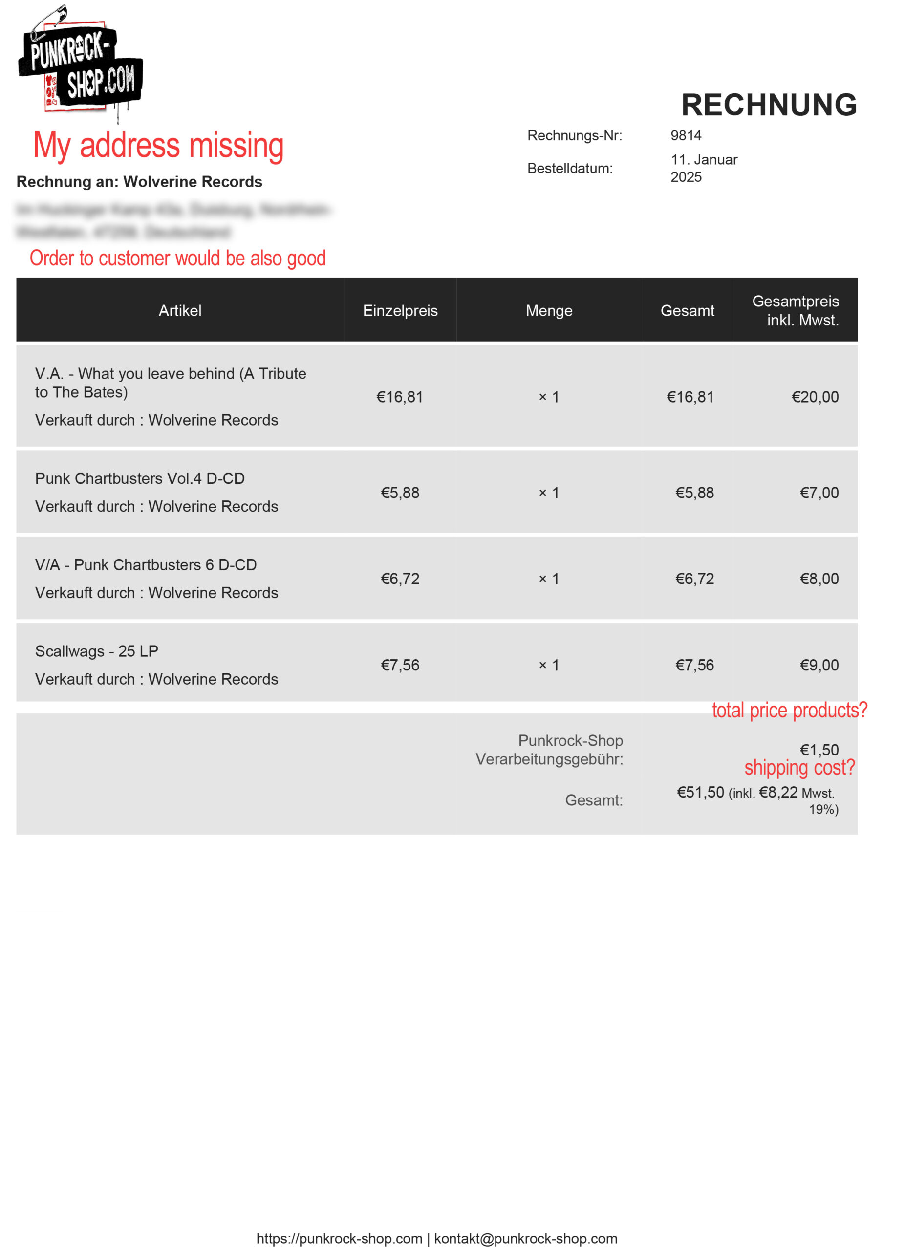

      For the invoice issue. It would be great, to have more settings. In Germany we need a lot of “important” things on the invoice.
      1. It would be cool, to have the columns like this (or with an option to switch on, off, what you need): price without taxes, amount, total price, taxes for the position, total price with taxes
      2. The address of the shop should be on the invoice (not sure, if I did this as a change, or if it was there before).
      Also it would be good to have the address of the main-shop, the vendor and the customer on the invoice-for order and invoice-for-vendor.
      3. In the last row there it would be good to have the option for ordering: total price (netto), shipping-cost (option to show with or without tax), total price (brutto) with an information, how many taxes are included (e.g. “incl. 5€ 7% taxes, 35€ 19% taxes”)
      4. Speaking of invoices: could there be a possibility, that the invoice-numbers are generated automatically at an order? To have it a bit easier I just changed the Order Number to the Invoice Number now.

      Regarding your queries with the invoice module our replies are inline –
      >> Our dev team has checked this and found out that currently there is no such flexibility for adding new fields in the settings section. However, in the future they will surely add the functionality accordingly so that you can add new fields as per your choice.
      >>Currently on the invoices the address of the main website comes accordingly https://tinyurl.com/23s3dc7q by default. So kindly check carefully on your end with the default structure and let us know if you need any further assistance.
      >> We already have the option of showing the tax, shipping etc. field in the settings section and once those are selected the tax details , shipping cost, total amount come on the invoice accordingly (https://tinyurl.com/2cden9nu). Now may I know what changes do you want to have in these default sections.
      >> Currently there is a setting for putting invoice number format in the settings section (https://prnt.sc/wbNWWDu38Yey). And the invoice number is generated automatically using that format (https://tinyurl.com/26tluwbr). Kindly check this on your end and let us know more in details if you are looking for any further changes.
